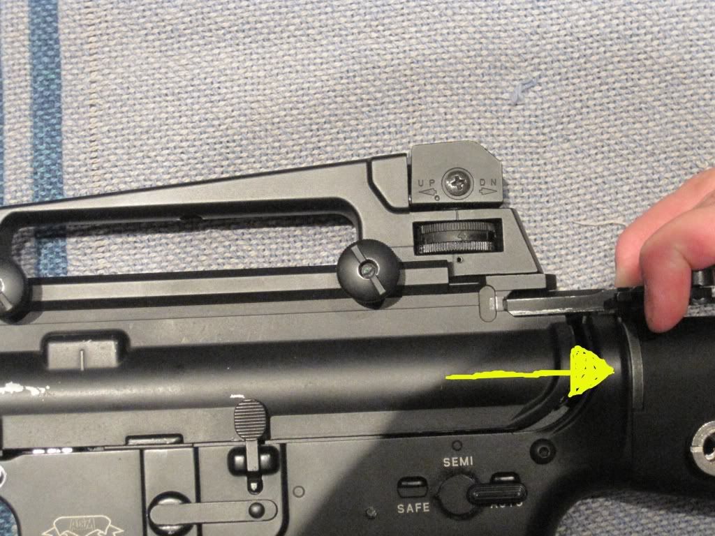

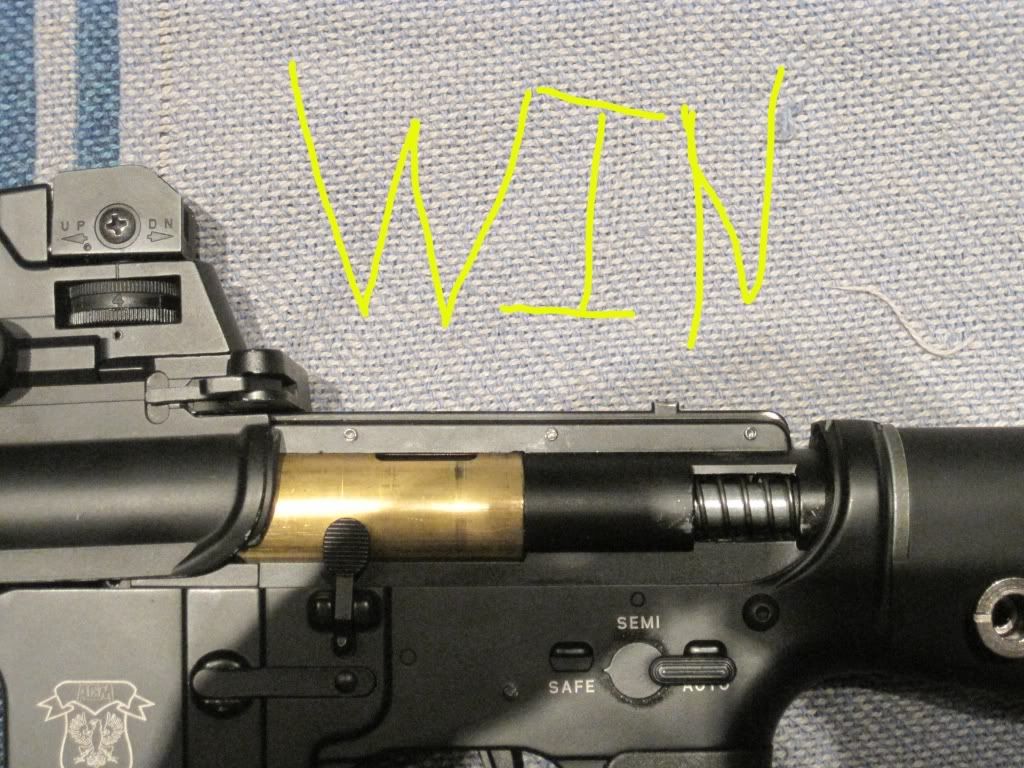

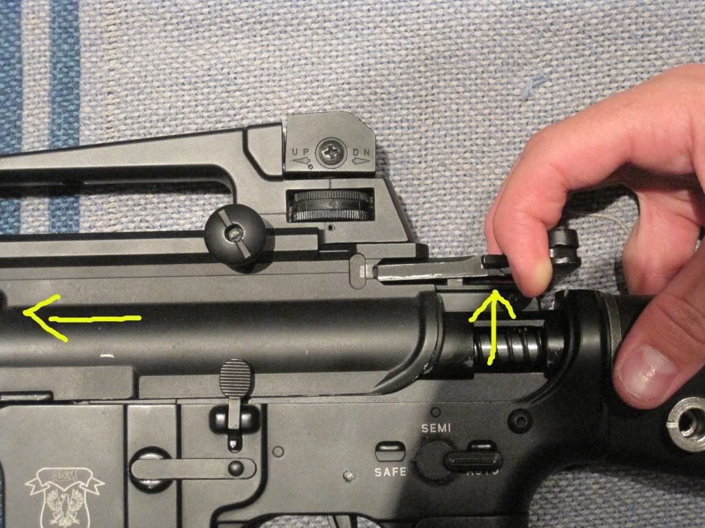

Postby G36 FTW » Fri Jul 02, 2010 10:25 pm
I just so happened to need to get into my AGM m4, which opens in the same way as G&G m4s, so I decided to make a guide. :roll:
First off, the problem is with the nub on the top of the V2 gearbox (seen under the N in the last picture, so you just need to do this; after removing the receiver pins/magazine (IF your magazine is still in, that’s the problem- I've done that several times lol :lol: )
Pull out the charging handle.
Pull up the charging handle over the gearbox nub- while sliding the receiver off.
You WIN! (nub under the N was the problem, little bastard isn’t it?) ;)
