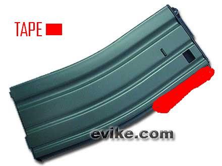

I had trouble getting Star mags to feed in my ICS M4. I put electrical tape on the the rear spine the length of the mag that goes into the magwell.
Now it feeds fine.
