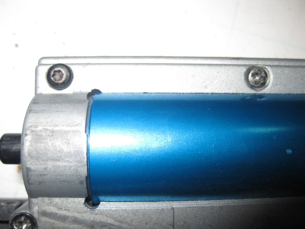

Jester, may I recommend drilling relief holes next time. This helps save the gearbox by dissipating the impact energy of the piston over a wider area. See picture.

Nec wrote:Jester, may I recommend drilling relief holes next time. This helps save the gearbox by dissipating the impact energy of the piston over a wider area. See picture.
Do you have proof that actually works? It's an interesting concept at least.
I don't have any real proof through testing with gearboxs, no numbers or pictures, although I've done it on all of my Ver2 gearboxs that show signs of cracking. This isn't a new concept, it's called "stop-drilling" and is used in the areospace industry for this very same purpose. Sharp corner are more prone to cracking than rounded corners.

Postby Blizzard » Wed Feb 23, 2011 11:09 am
Interesting, I think I'm going to try that.
So you said they were showing signs of cracking. Did they eventually bust after this mod?

V2 gearboxes can run just fine on an M120 or M130 on an 11.1v lipo, but you have to do it right.
A HUGE issue is having radiused corners on the front of the cylinder cutout area. If you look at the edges of the mechbox cutout where Jester's cylinder sits, the corners are square. This means that all the force is directed perfectly at the joint of the corner, causing it to eventually crack. If these corners had been radiused, were a small circle is cut out right at the corner, the curve spreads out the force and prevents cracking. Good quality mechboxes come like this and rarely crack.

Well since you didn't seemed to like the CNC'd machined idea I threw out there, you might want to look into sorbothane padding your piston head and cylinder. You can use the sorbo to correct AoE too and it really does relieve the impact and cause a HUGE decrease in stress. It also oddly makes the gun alot quieter..
