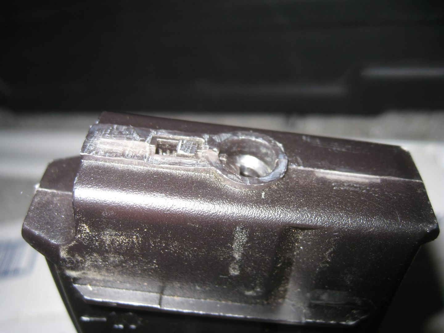

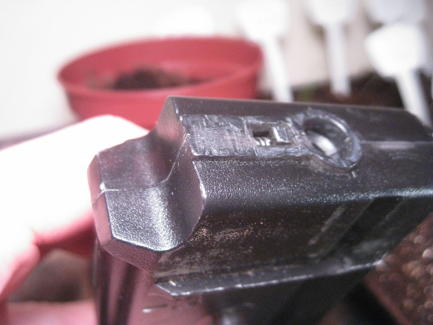

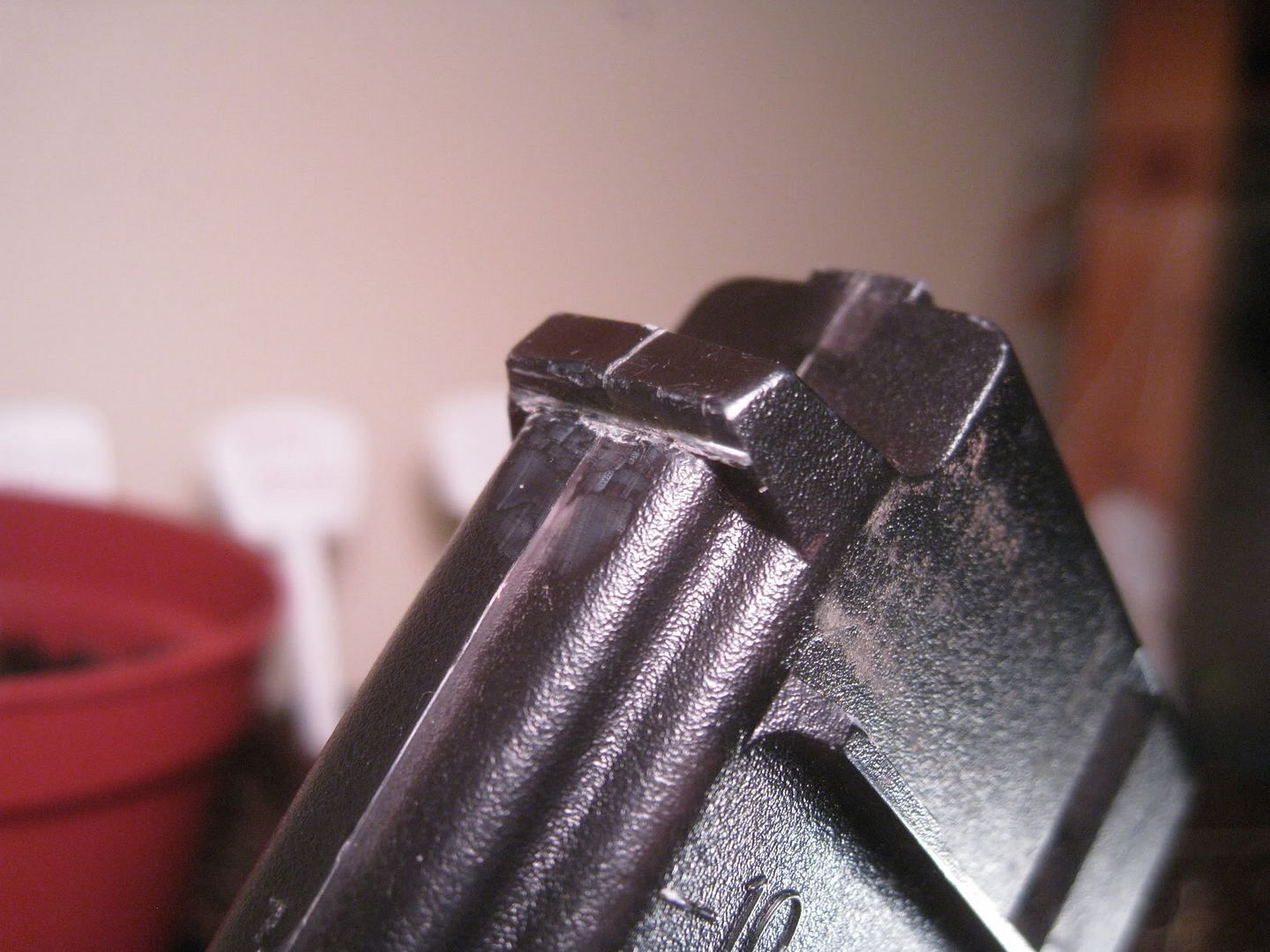

Postby Jewish Ninja » Wed Apr 06, 2011 11:58 pm
Did he shave the top of the mags/ the mag catch area to make sure they lock in correctly? I had to do that (same setup) to get them to run correctly. I also lubed them up and taped the bottom to make sure the stopper didn't go flying out.

Postby Jewish Ninja » Fri Apr 08, 2011 9:05 am
For shaving the mags, here's some pictures of what I did. I don't have an unmodded mag to compare it to, but it gives you an idea. I would start by shaving the top down a bit, then the mag catch area, then back to the top etc. until they seat just fine. I found it was best to alternate the areas I was shaving to ensure a snug fit. One mag I went whole hog on shaving the top which made it a bit loose.
