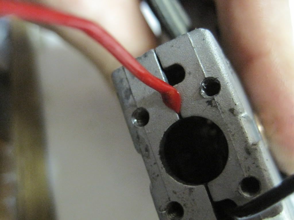

It's either what Minerva said or you have a short.
Be sure you don't have something like this going on.

Well, after I took the gearbox out, I plugged everything in again. All parts look like they work fine, and in no position of the selector plate did the gun fire on it's own. The motor turned over only when I pulled the trigger. As this is the case, I don't think it's a trigger contact issue. Could the independent firing really be just due to a short?

it probably is, if nothing inside your gearbox is jacked up. Make sure that you shrink wrapped the connections on your deans, that no wires are pinched in the gearbox, and that there's no stripped parts on the wires.

Could be. Try inspecting your motor endbell and such for shorts. Also try checking to see if all your connectors are properly attached
