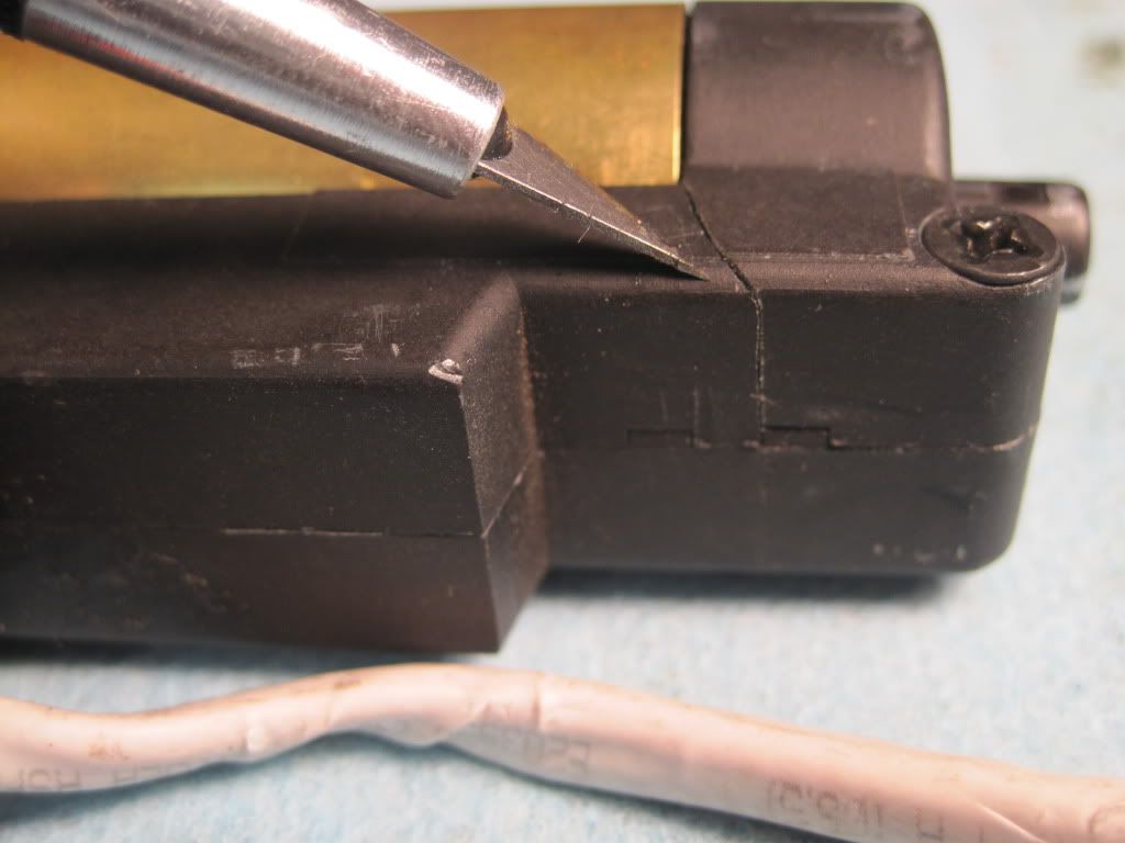

Below is a picture of the latest cracked 1st gen KWA gearbox that came to me. This was used under stock conditions for a little more than a year with heavy use. The gearbox was taken apart a few times before but no parts were changed or replaced and I might add this person did not use any type of lipo batteries on this gearbox, only NiMh and NiCads.
Blitzkreig wrote:2. I believe the gearbox shell is proprietary. Maybe not, but maybe.
Yes and no, KWA uses standard version 2 (and version 3 for their G36c) gearboxes although many gearboxes do not fit properly fit in KWA receivers such as, but not limited to; CA, G&P, and Echo 1. They may have changed this with their gen 2, although I doubt it.
