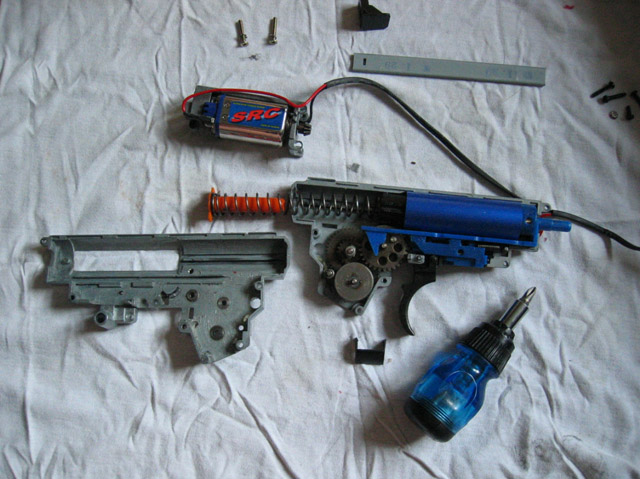

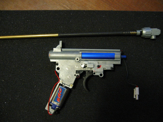

Stripping the rifle down is as easy as it gets. The G36 is a modular rifle and this replica is no different. With the removal of just a couple of pins the entire replica comes apart into four major sub-assemblies. Remove the RIS and the magazine well, then the lower drops out and you can remove the inner barrel and gearbox. It took me about 60 seconds to disassemble my replica down to the bucking and gearbox.
The inner-barrel assembly is nothing remarkable. A 355 mm brass 6.08 mm inner barrel, the standard flimsy black bucking, and a hop-up unit constructed entirely of metal. Team SD has included a nice piece of black shrink-wrap to cover the barrel in case a glimpse of brass could be seen through the RIS. A nice touch, if you ask me.

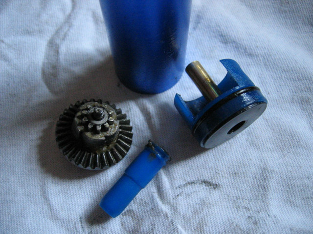

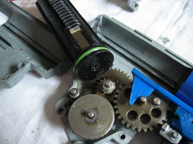

The gearbox is a non-reinforced version 3 type, equipped with an upgraded SRC "ultra-high-torque" motor. The first thing you notice externally are the metal bushings. The only tool needed to take apart your G36 and its gearbox is a Phillips screwdriver. Once inside the gearbox I was impressed with the lubrication. There was sufficient lube to run nicely, and not enough to make a mess and collect all the dirt in the world. The selector plate, tappet plate, nozzle, switch assembly, and cylinder head are all made of a blue plastic. The cylinder is anodized inside and out with a matching blue. The spring guide is made of thin orange plastic and has an O-ring in place of a bearing. The 110 equivalent spring is integrated with the piston assembly making it all one piece. The piston and vented head are made of a black polycarbonate with a green O-ring. The gears were unmarked, and according to TSD, they are an upgraded steel gear set. The shims are metal and quite honestly the factory did a superb job shimming it. Compression was much better than I had expected, certainly suitable for a skirmish rifle.
