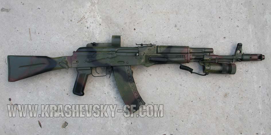

That is definitely NOT a spetsnaz AK.
This is a modern FSB spetsnaz AK. As you wish, not black.
Also, why tan? We live in the Pacific Northwest. Pretty much everything here is green.
