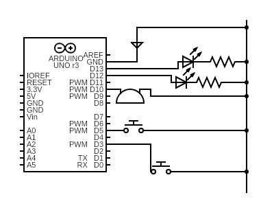

Back in October I had a bunch of friends over and one of the last airsoft games we played was capture the flag. The two teams were spaced about the same distance apart from the flag. To win you had to get a team member within 10 feet of the flag and keep them alive for 5 minutes. If you accomplished that then that team won. Recently I decided to try and make a electronic "flag" for this game. There is a button, light, and buzzer(correction, very loud buzzer). To win you have to hold the button down for 2 minutes and during that time a light turns on and the buzzer goes off to warn the opposing team you are capturing the flag. After the two minutes the led and buzzer will turn on for 10 seconds to tell everyone that the game is over. I will add a schematic and the code if anyone wants to replicate this for their own use. If you have any other questions feel free to ask.

Here is the circuit schematic.
