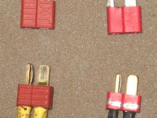

Well, take a look for yourself.
ImageAs you can see, the contact area is must larger and the "plugs" are gold plated for less resistance unlike the tamyia connectors which are much much smaller and are made of aluminum. You can buy the "name brand" [pictured on the right] from your local hobby store for about $3.50 for a pair. the left shows "hobbycity" knock off brand deans which are very nice for how cheap they were and plus they have those "ribs" for easier disconnecting, I say were because they do not sell them any more.
Warning: Be sure to solder the tabs on correctly!
Whoever invented "Tamiya's" should be shot", they just over all suck.

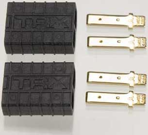

Postby buds hanzo sword » Tue May 26, 2009 6:59 pm
I use these. Easier to solder (not that it matters to me really, I used to solder all day at work) and look more tactical than deans :D

Postby wake.joe » Tue May 26, 2009 7:04 pm
buds hanzo sword wrote:I use these. Easier to solder (not that it matters to me really, I used to solder all day at work) and look more tactical than deans :D
Used those for awhile. They're nice, but I recently went back to Deans. Traxxas one's were too big.
