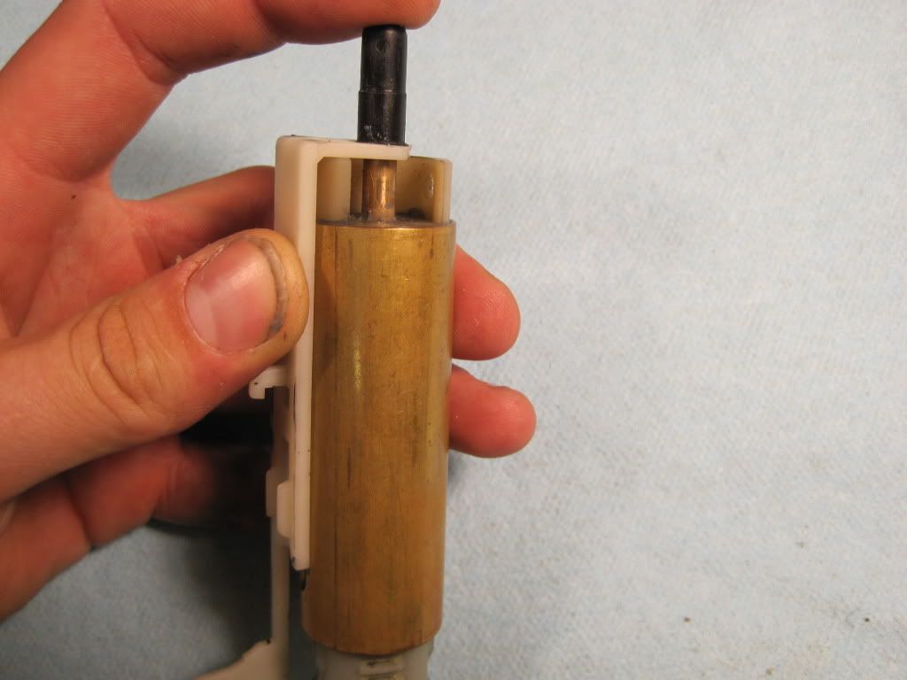

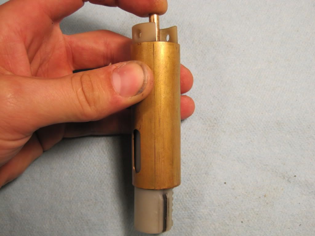

It seems you know how to check for good compression already, but incase you are doing it wrong lets start from square one.
Plug the cylinder head with your finger and running the piston up and down in a somewhat fast motion you should get firm pressure resisting your push in.

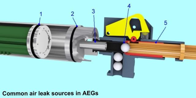

The most common place for leaks while doing this compression check is the piston head O-ring, replace with a #14 O-ring available at Lowes or any other well stocked hardware store. If you have already replaced the piston head O-ring and still getting bad compression you may want to do the cylinder Teflon mod, by wrapping Teflon tape (AKA plumber tape) around the cylinder head’s O-ring (sorry no pictures). Although a better alternative would be to either try a another cylinder or buy a new cylinder O-ring, IIRC it is a #19 O-ring available, you guessed it, at any well stocked hardware store
Next take the air-nozzle and place it on the cylinder head and clip on the tappet plate so that it looks like this:
Why do this? Because when the gearbox is put together and the piston is about to go forward the air nozzle is pushed although way out so that it can make good compression with the "lips" of the hop-up bucking. Running the piston up and down in a somewhat fast motion you should get firm pressure resisting your push in.

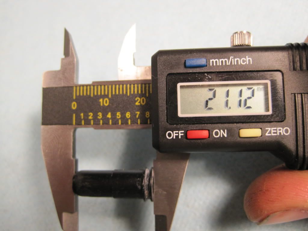

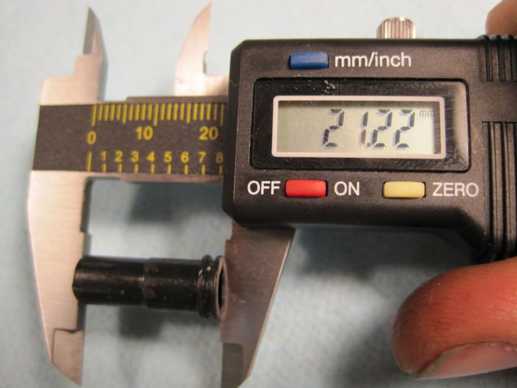

If you don’t find a leak here but when you put the gun back together you get really bad FPS, trying switch out the air nozzle with a longer one. When I saw replace it with a longer one, I’m not talking about one that’s twice as long I’m talking about one that is microscopically longer such longer by .1mm - .2mm longer.
Lets say your stock air nozzle is 21.12mm long.
Try replacing it with a 21.22mm air nozzle.
Here are some other places to check for compression.
