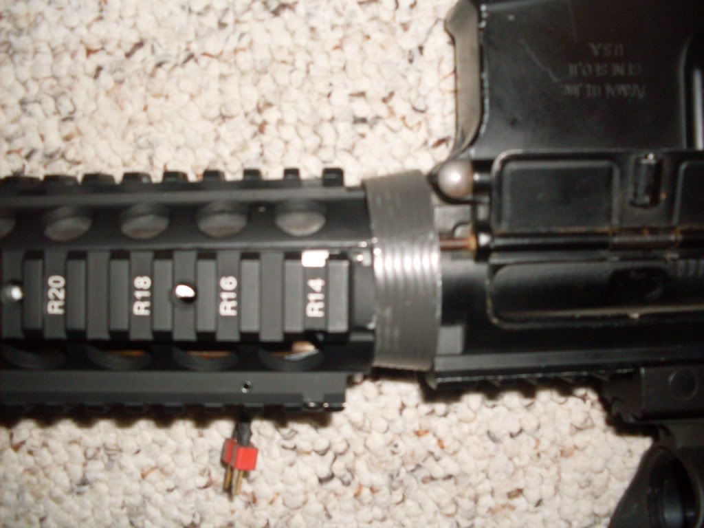

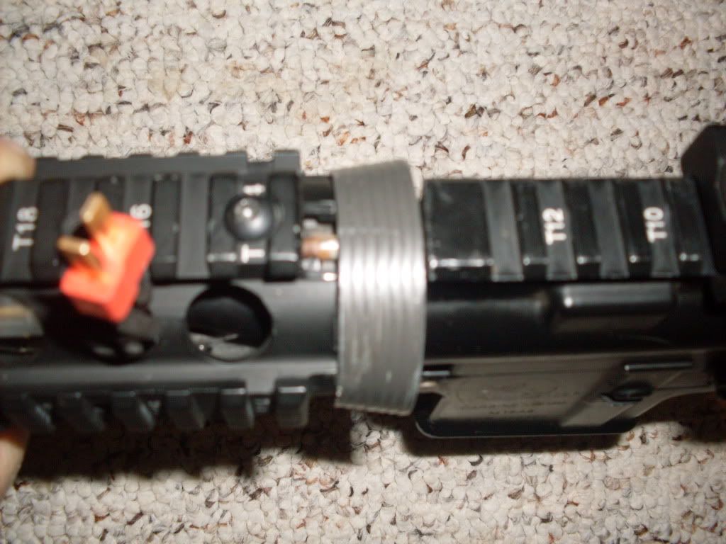

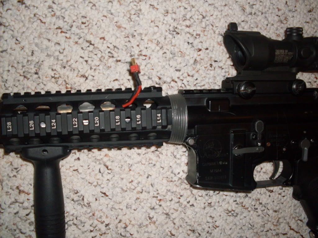

Postby Limpy » Sat Feb 12, 2011 6:00 pm
Beran wrote:can you take a picture of i as far on as you can get it? there's a couple of different places they can bind up when you are trying to install them. also, did you make sure the little screw down clamp at the back top of the rail is loose and out of the way? i had one of those once that i messed with for an hour before i realized it was tightened up and was interfering with the delta ring.
Yep, here you go:
From the side: Image
and
From the top: Image
From the other side: Image

Postby Blitzkreig » Sat Feb 12, 2011 6:12 pm

Postby Beran » Sat Feb 12, 2011 9:15 pm
yeah, get that top three sided rail on first and then the bottom one. i cant quite tell, but it looks like the locking bracket is on top of the delta ring. loosen the screw up on the top rear that holds that little claw looking thing in place, then slip the claw underneath the ring and try and seat the rail then tighten the claw back down again. if you want to see how well it fits beforehand you can try and just remove the locking claw and see how it works. honestly, that's what i would try first just to see if it works. if you can get it on without that, it will fit without the d-ring it came with.
