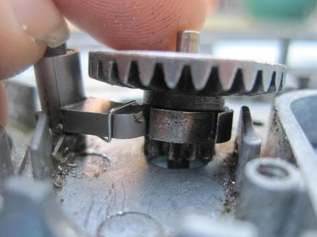

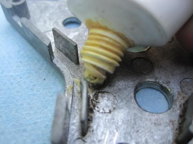

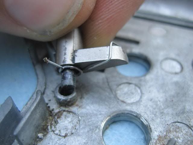

Speaking of working on them, I got the gearbox back together, but the antireversal fell out in the process and I'm pretty sure I didn't get it back in correctly. I'd appreciate a picture of a gearbox that shows the little spring's correct position.
Pictures:
*Note this is an old test gearbox. I attempted to drill out the bushing holes at one time with a drill bit, this gearbox does not have any bushings installed.
This is what the connection between the reversal latch and bevel gear should look like when the gearbox is closed.
Sometimes if the anti reversal latch has a stiff spring or is just a pain in the a$$ I’ll put a small blob of grease in the hole to keep it from “exploding”. KWA guns fit together quite nicely so you shouldn’t have a problem.

Ah.
Yep, it's on the wrong side of the bevel gear.
Thanks for your help.
