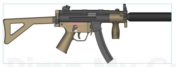

Postby Icepick » Sun Oct 23, 2011 7:48 pm
(Bump, I guess.)
Here is an idea of what I'm going for:

Postby Minerva » Sun Oct 23, 2011 7:59 pm
Jewish Ninja wrote:I put a stock TM p90 barrel in my MP5k and I didn't need to change the cylinder.
Icepick, I'd look for a nice tiny 7.2 lipo as the stock stick battery is worthless.
I suppose you wouldn't "need" to.. but you would lose some velocity..
Actually a 7.4v/11.1v stick fit just fine in it..
Yuppers. That cylinder.
Trust me though, MP5k's are just moar fun when they are super compact.
Oh and: My MP5k the way you want. It looks cool, but I'd rather have no mock suppressor in CQC
