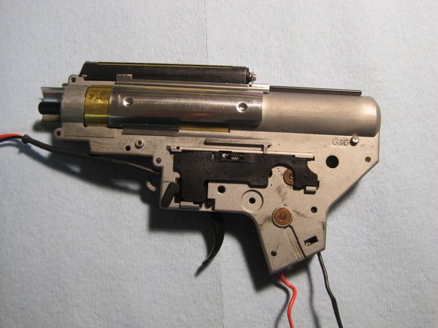

I've worked on a few in the past, good guns. There are a few things I would like to say about them.
The blowback system makes them difficult to take apart compared to other blowback systems and non blowbacks.
The cylinder has a small hole on the top for air to power the blowback system; keep in mind if the cylinder gets turned or shifted at all you will have a huge drop in FPS. Also replacing the cylinder with one that isn't designed for the G&G blowback systems will disable the blowback system.
I have a few confirmed cases of G&G gears breaking under upgraded conditions, i.e. 11.1v lipos and m120 springs. However I have come across many G&G's which have been kept stock and ran for years without a hitch.
Here are the latest two cases, both were ran with an 11.1v Lipo on a stock spring.
The fuse for the fuse box, isn’t a standard fuse that you can get at an auto parts store. I have yet to find a replacement fuse.
G&G AEGs use smaller, 18AWG wire compared to most other brands which use 16AWG wire. You may find the wire getting hot after a couple thousand rounds while using a lipo or upgrades.
Motors are pretty poopy, under stock conditions they can hold their own but the magnets aren't strong enough to take much in the way of upgrading, i.e. high speed or high torque set ups.
The gearbox comes sock with relief holes drilled in the front of the gearbox, this is to prevent the front of the gearbox from cracking which is an all to common problem for the version 2 gearbox design. I have yet to see a G&G version two gearbox crack even under upgrades.
The paint on the metal bodies is very durable, it isn't easily scratch. IMO much better than CA.

Couple things nec, First off, did that gun ever get opened and shimmed via the bevel? Or was it done the traditional spur way? You can tell the shimming was off by the grease patterns on the spur gear in that first picture.
Secondly, I think most middle of the road brands use 18awg. Some higher end brands I have found 16awg in, and actually some lower end ones too. Which ones have you found 16awg stock in? Because I usually end up replacing the entire harness with some 16awg PTFE silver plated wire and it'd be nice to find a reliable manufacturer who has some decent wire stock
Third, did that come with that much grease in it?
And Grease, really as long as you have a good hop up setup then barrel length past 363mm is just for looks. If you want to go ahead but you have to switch the cylinder out to match the extra barrel length

Minerva wrote:Couple things nec, First off, did that gun ever get opened and shimmed via the bevel? Or was it done the traditional spur way? You can tell the shimming was off by the grease patterns on the spur gear in that first picture.
The first picture was a G&G m4, running stock and never opened before that picture was taken. It had less than 12,000 rounds on a 11.1v lipo. I don’t see how that gear was improperly shimmed; the grease pattern is just inconsistent. Interestingly the bevel gear did not have any broken teeth; this leads me to believe the spur gear was poorly made.
The second picture is of the G&G blowback m4 (from the gearbox pictured), it was opened up and shimmed and greased at 10,000 rounds, lasted another 20,000 rounds on non lipo battery. When I got the gun it was said that it was running louder than normal. Opened up the gun and found the two gears stripped.
Minerva wrote:Secondly, I think most middle of the road brands use 18awg. Some higher end brands I have found 16awg in, and actually some lower end ones too. Which ones have you found 16awg stock in? Because I usually end up replacing the entire harness with some 16awg PTFE silver plated wire and it'd be nice to find a reliable manufacturer who has some decent wire stock
Most of the manufactures I’ve worked on are 16AWG. Again most, there are a few brands out there, which I can’t remember the names of, but they use 18AWG. I work on mostly JGs, and they all have 16AWG, I’ll be it there are differences between thicknesses of insulations.
Minerva wrote:Third, did that come with that much grease in it?
No, it didn’t. I put grease on the gears because the owner said it was “noisy” and because it was dry as a bone when I got it the first thing I did was put grease on it, spun it a few times by hand and noticed the stripped gear. I usually wipe of the grease so there is only a thin film.
