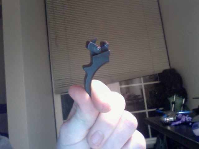

The first thing was the trigger:
http://i778.photobucket.com/albums/yy68/matteumayo/Photoon2010-12-16at1807.jpg?t=1292551790

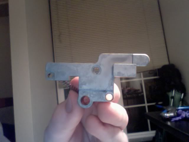

Another thing was this strange piece of metal and a small spring, which came off the gearbox casing by a loose screw. I don't know where the spring goes or how to put it back.
http://i778.photobucket.com/albums/yy68/matteumayo/Photoon2010-12-16at1806.jpg?t=1292551964

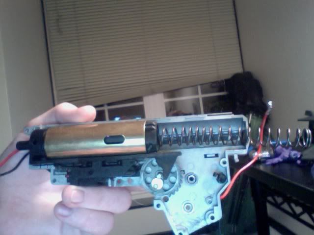

Here's a picture inside the gearbox. Two gears fell out, and this one very small (maybe 1.5mm thick) spring type thing with two thin metal pieces on each side sticking up and down.
http://i778.photobucket.com/albums/yy68/matteumayo/Photoon2010-12-16at1805.jpg?t=1292552141

Postby G36 FTW » Thu Dec 16, 2010 7:30 pm
The g36 trigger is a phony pony, even I hate messing with them. You need to insert the trigger and trigger spring and then have someone else hold it down as you reassemble the rest of the gearbox; it is very VERY hard to do by yourself (I've managed to hold it in temporarily with duck tape but it is still a major pain).
The weird metal thing goes on the outside of the right piece of the gearbox after it is put together (the spring rests in a slot between it and the gearbox).
And I'm not understanding your last picture/question... Could you highlight in the picture exactly what you are talking about?
If you need more help I can post some pictures of where various things go.

Postby matteumayo » Thu Dec 16, 2010 7:32 pm
G36 FTW wrote:The g36 trigger is a phony pony, even I hate messing with them. You need to insert the trigger and trigger spring and then have someone else hold it down as you reassemble the rest of the gearbox; it is very VERY hard to do by yourself (I've managed to hold it in temporarily with duck tape but it is still a major pain).
Okay I'll try to upload some more pics of the last thing I talked about.
One thing in that last pic is the gears are gone, I'll circle them though.

Postby matteumayo » Thu Dec 16, 2010 7:46 pm
I watched that video and got the gears back by taking off the tab-t(spelling) plate and placing them as seen. However, I still have no idea how to put the trigger and that weird spring thing back!

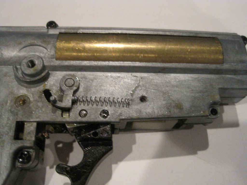

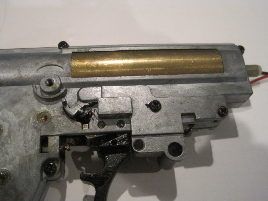

Postby G36 FTW » Thu Dec 16, 2010 7:47 pm
That would be the trigger-spring.
And here is pictures of the weird metal plate in your second picture of your original post.
Where it goes:
With it installed.

Postby matteumayo » Thu Dec 16, 2010 7:53 pm
Where it goes:
With it installed.
Thanks.

Postby matteumayo » Thu Dec 16, 2010 8:01 pm
G36 FTW wrote:
matteumayo wrote:Thanks.
I just have to find out how to put the tab-t plate back on...
I'll keep watching the video.
No problem.
You mean the tappet plate?
Yeah, tappet plate.
I can't seem to get the gears right though. In the above video he puts that metal latch thing by the gears, he says there's a spring keeping it from spinning a full 360 degrees, however mine just spins, and there is no spring.

Postby G36 FTW » Thu Dec 16, 2010 8:12 pm
matteumayo wrote:
No problem.
Yeah, tappet plate.
I'm still having trouble with the tappet plate, putting the cylinder and stuff into the gearbox in one piece, and closing the gearbox though...
Then you may be missing the spring that goes with the anti-reversal latch. It is rather small and is easily miss placed- unfortunately you will need to replace it if you can't find it.

Postby matteumayo » Thu Dec 16, 2010 9:30 pm
So I can't find that spring any where.
But there is no way there was ever a spring, because all of this was done in a contained area, and it all stayed there.
Perhaps the KWA G36c's don't have a anti-reversal latch spring?
Here's a pic, please tell me if there's anything wrong with the gearbox before I close it up!
That anti-reversal thing is near the bottom middle.
http://s778.photobucket.com/albums/yy68/matteumayo/?action=view&current=Photoon2010-12-16at1953.jpg
matteumayo
Posts: 105
Joined: Sun Aug 01, 2010 11:10 pm
Postby matteumayo » Thu Dec 16, 2010 9:40 pm
Shoot.
turns out that I have that latch upside-down. You can see that in the pic.
Guess I'll keep looking...
