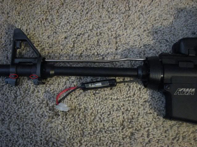

Postby Vamp » Wed Mar 16, 2011 3:43 pm
having trouble getting the delta ring off even with a delta ring tool am I doing something wrong or what can someone send another photo. it is similar to the problem that broke the barrel in the first place the flash hider was on too tight or they locktighted it or something. and before anyone says anything I am not a total retard I took the allen screw out of the flashhider and was turning it counter clockwise. anyways I have tried useing the delta ring tool a half a dozen ways with quite a bit of force and still cant seem to get it off

Postby Vamp » Wed Mar 16, 2011 3:53 pm
ok lol just saw the video link that i had somehow not been seeing but that perplexes me more because the delta ring is extremely tight has anyone else had this problem with KM4A1's

Postby Vamp » Wed Mar 16, 2011 4:53 pm
Kay it took a bench vice and a good amount of my 240lb wieght but it finally came off. thanks again guys for all the help.
