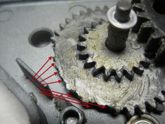

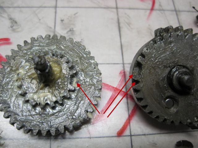

I usually say “every gun is lipo ready” but I must say I am not too impressed with G&G gear seats. Their Motors aren’t too “punchy” and have low speed and torque for such a high end gun. 18AWG is standard G&G wire; it would be nice to see a bigger gauge of wire used such as 16AWG or 14AWG because they can handle the amperage load of Lipos better. I’ve owned two G&G UMPs and have worked on more than a half-a-dozen G&Gs including their blowback series. Both of my G&G gear sets went belly up within about 50,000 rounds or so and about half of all G&G’s that come to me have stripped gears. On the other hand my best friend has only seen a few G&G gear sets fail, maybe all the bad sets come to me? I don't know, but from what I've seen I don't like G&G gears.
Here are two of the latest cases;
G&G non-blowback M4, This guy came in telling me the pinion gear is stripped come to find out 1/3 of the spur gear was completely stripped! He bought this gun about 2 years ago it has been used almost everyone other weekend and has only been using NiMh batteries!
This next case is from a G&G Blow-back series; guy came in and asked for a simple MOSFET installation. When I opened the gearbox to install new wiring I found two teeth on sector gear and one tooth on the spur gear stripped off. IIRC this guy has had the gun for a little more than a year and just recently used 11.1v lipos.

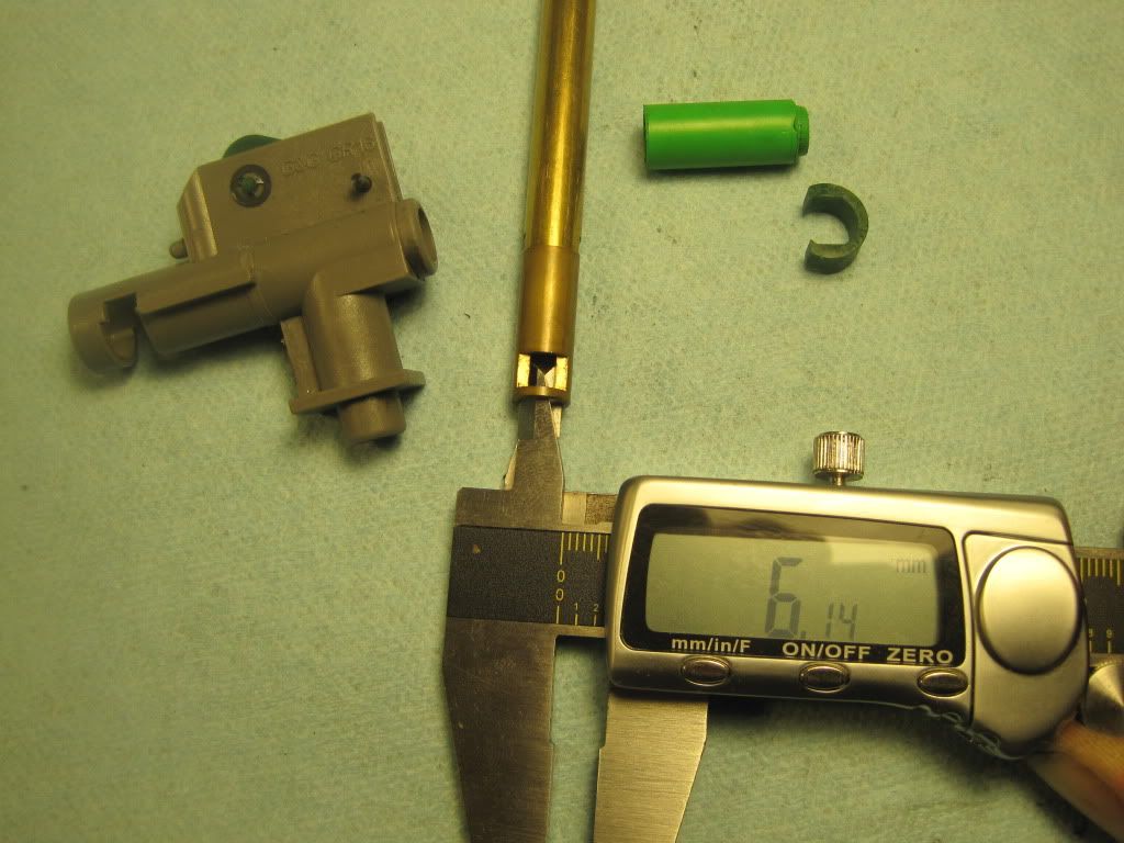

I would replace the barrel with a tightbore, as according to my findings their inner diameter is 6.14!

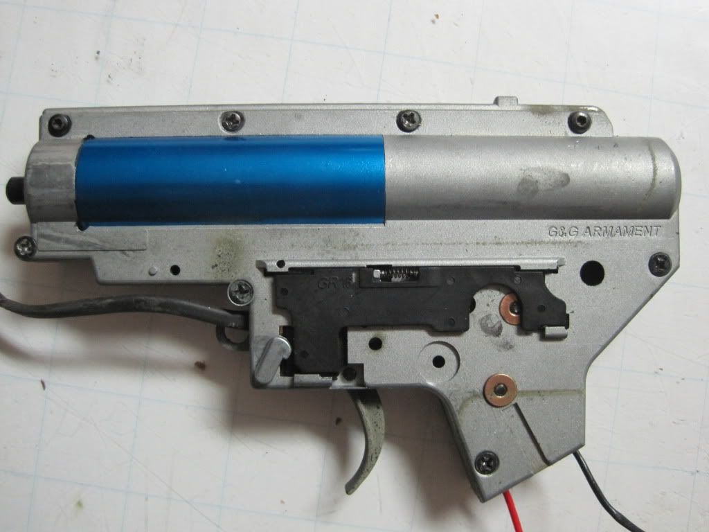

What’s interesting about G&G’s gearboxs is the screws are on the left side instead of the right side of gearbox like 99% of all other brands and their use of “brass” or supposedly brass bushings. The newer models seem to come with ball bears instead of bushings now (*source needed). I’ve seen no reports of problems with the brass bushings and as for the screw placement I just find it annoying. Pictures;
Please note: This G&G gearbox’s cylinder and screws are NOT stock. ALL G&G gearbox screws use Allen keys instead of Phillips. This is just to show the placement of the screws.

First off I would stay away from Systema and Classic Army gears. I have two sets of Systema gears in my "broken box", the teeth seem weak and after ~50,000 rounds the teeth start to bend making a lot of noise. I myself have 2 confirmed cases of new gen stock Classic Army gears stripping within less than 40,000 rounds. A best friend of mine, who works on more AEGs than I do, has seen more than a dozen cases where Classic Army gears stripped under stock conditions. I'll have pictures to post of these gear sets later today.
